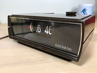

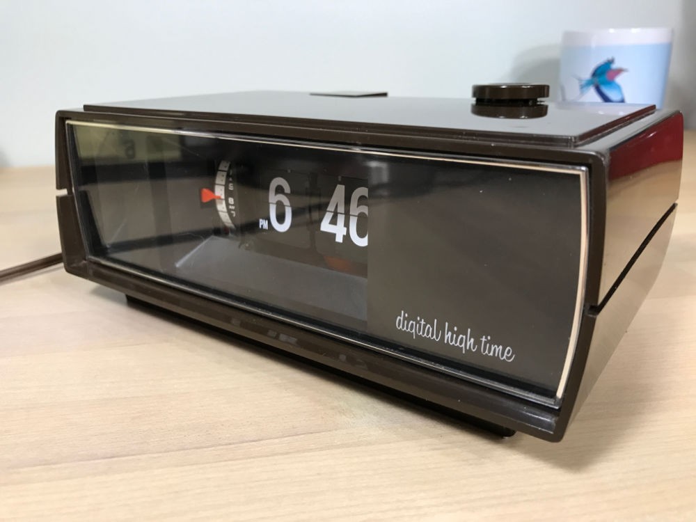

Right away you'll notice that this Digital High Time is not as big as you might suppose from online images. It's wider than a simple flip clock alarm, though, due to the mechanics of the time projection.

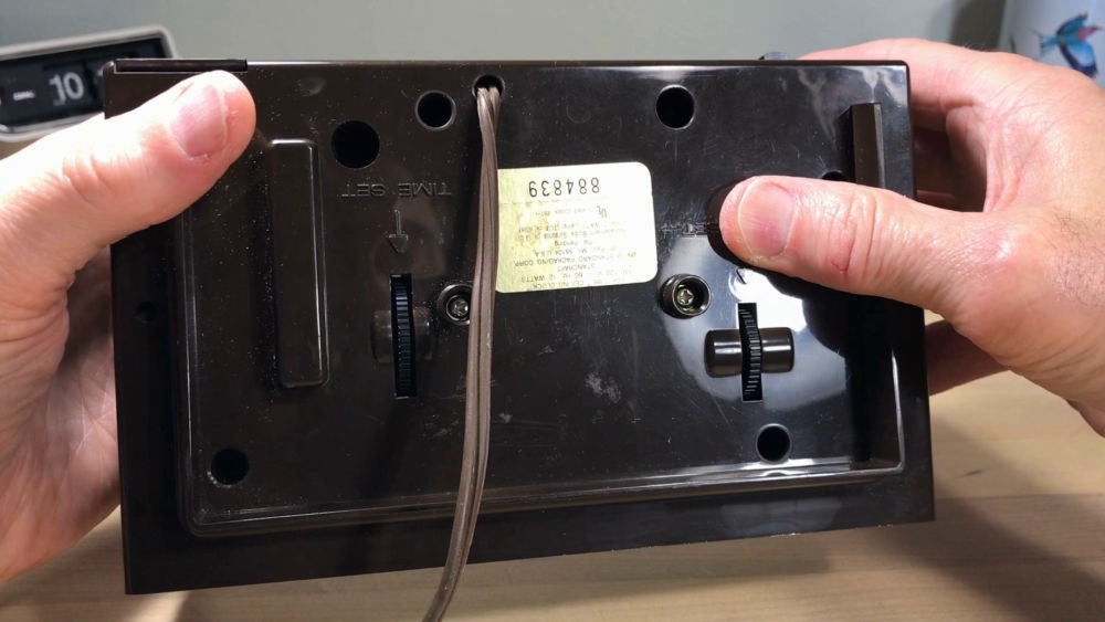

There are four screws to remove to open the clock and you'd be best served to use a number 1 Phillips-head screwdriver.

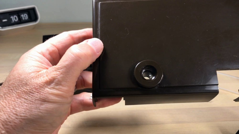

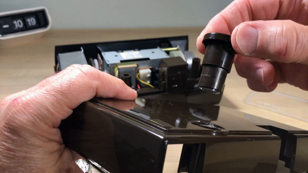

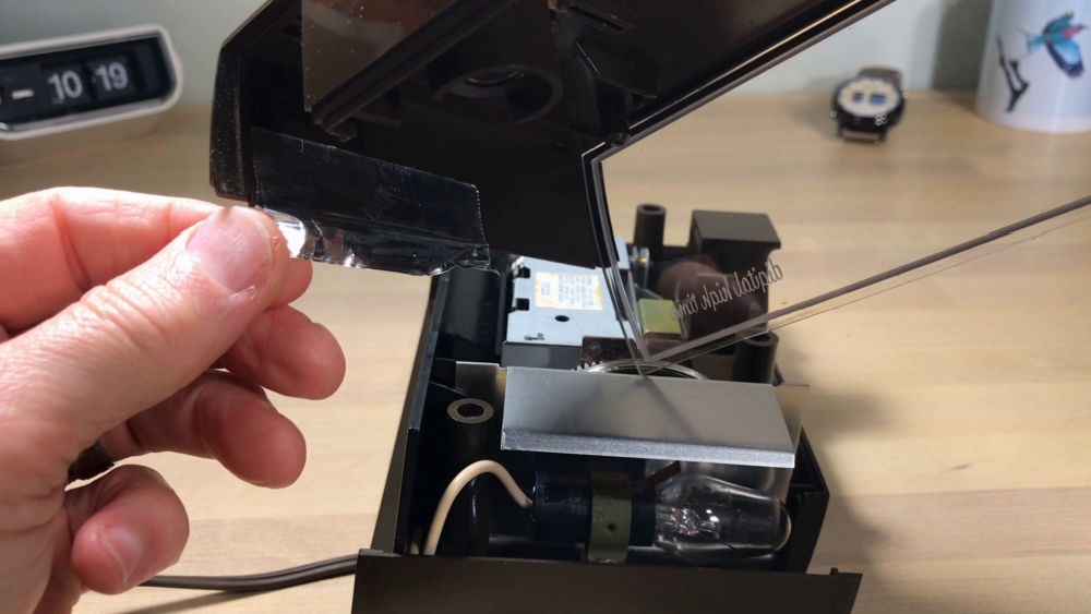

The top just lifts away but if it's never been taken apart it may be a little sticky. This may be due in part to this aluminum tape in the light compartment across the two case halves that probably helps protect against heat as well as to move the light in the proper direction. Here on the top, you'll see the projection lens assembly. When I looked one of these clocks in the past, I noticed that it was glued in position and was not intended to be adjustable, so that maybe a user could fine tune the projected time. However, on this clock, I broke it loose and discovered that there are indeed built-in ramps to allow fine adjustment. I believe that adjustments were done in the factory for an average ceiling height, then the assembly glued in place. In any event, I learned that you do not get much change anyway when moving the lens up and down, so you'd be better off not risking breaking this loose. But I'm glad I did just to see what it was all about.

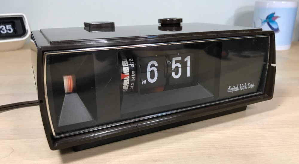

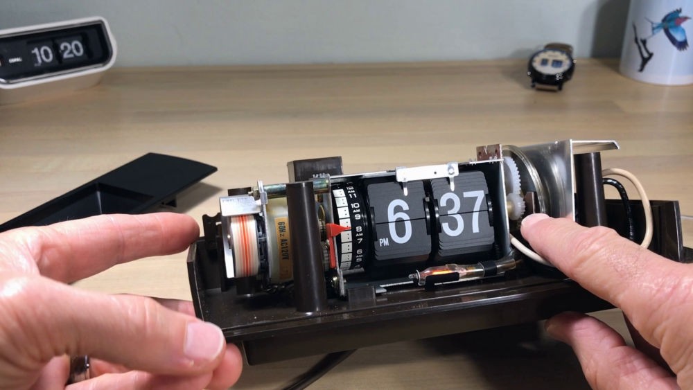

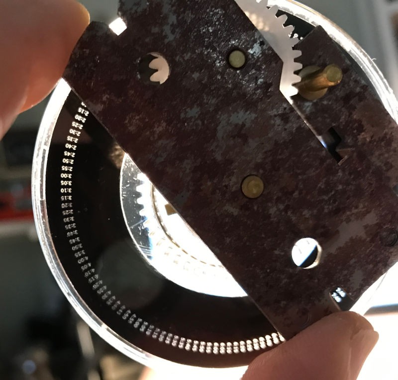

Here you can see the fine Copal mechanism. It's a customized one though because you have time adjustment on the right side in addition to an extension that will rotate the time wheel.

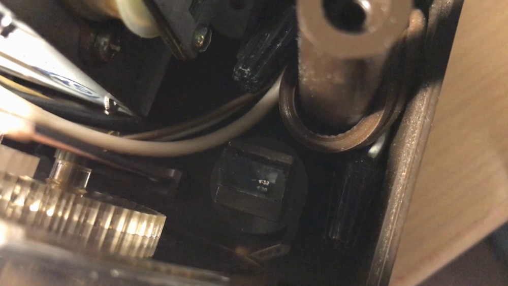

On this wheel you can see very, very small depictions of the time. If you look closely the method of projection is clear. This rather large bulb projects light through the small window in this metal plate. The light passes through the wheel projecting the image on a mirror that sends the image up through the lens assembly.
One thing the makers did well, was to seal off the light compartment so that there's not extraneous light throughout the clock or into the room. But a poor design turns out to be the very same feature. The light compartment is so well sealed that the heat generated will often warp the light door. Thankfully, the clock has a switch to enable or disable the projection lamp. Still, many times online you'll find a clock for sale that's missing this door.
