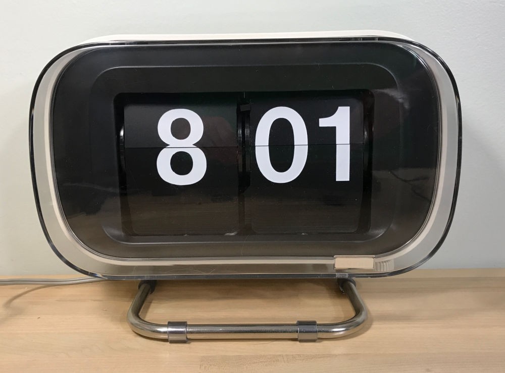

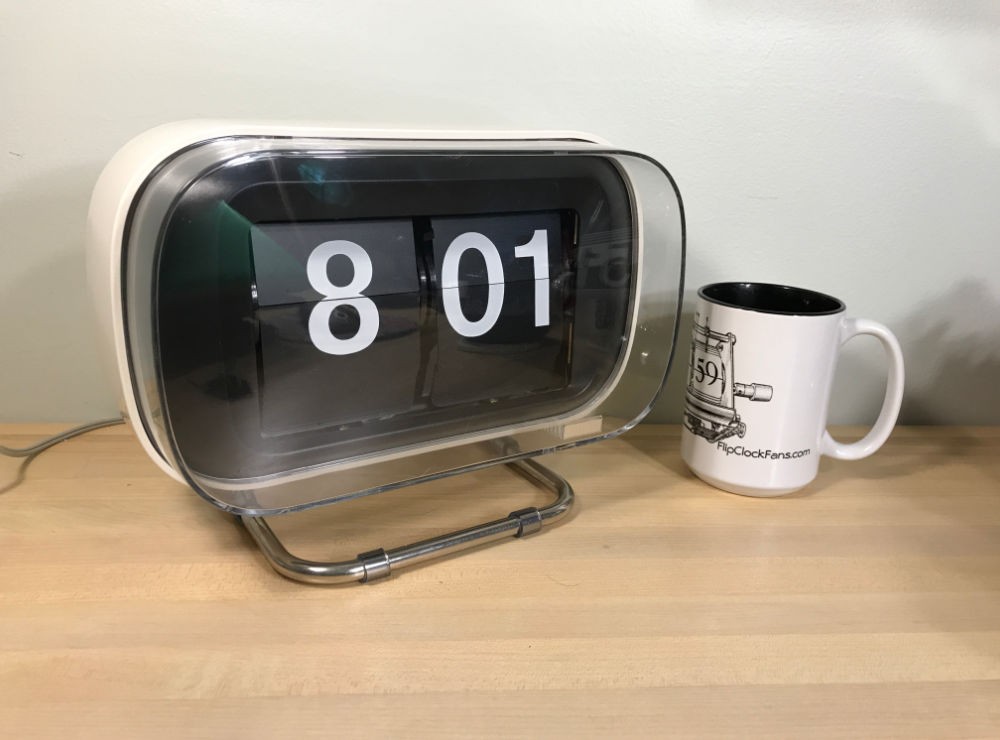

And there it is. It is clearly a Copal flip clock and is commonly believed to be the Copal 801.
It is a very to find flip clock, much harder than Marty McFly's clock, and is often quite expensive.

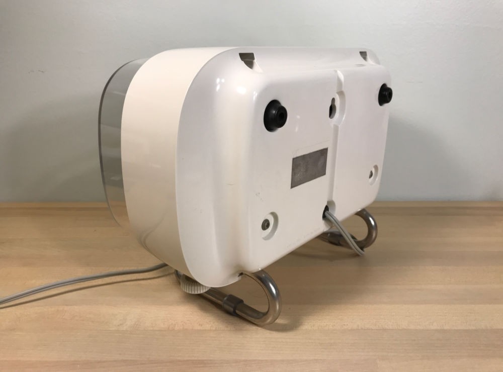

Click image for larger version  Name:	801clock.jpg Views:	0 Size:	97.7 KB ID:	25128 Click image for larger version  Name:	801clock2.jpg Views:	0 Size:	89.1 KB ID:	25129 Click image for larger version  Name:	801clock3.jpg Views:	0 Size:	65.5 KB ID:	25130
I did finally get one of these clocks in the recent past directly from Japan, and I'd like to go through it with you.
First, well, I whitened it. It needed it to some degree. It's not actually a white clock - more of an off-white or cream color, I suppose. But you could see the yellowing. And, since I've been in whitening mode, and there was plenty of hydrogen peroxide available in 40 Volume Developer at the time, I went ahead and brightened up the case.

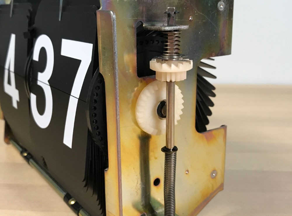

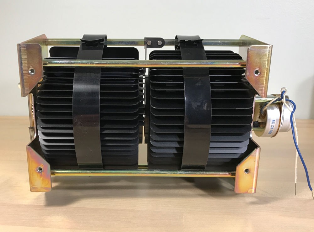

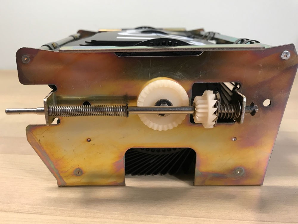

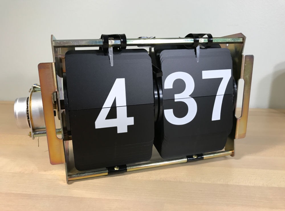

There aren't that many parts and pieces to come off the get the clock open. The first thing you'll notice is that the flip clock mechanism is huge.
Click image for larger version  Name:	801clock4.jpg Views:	0 Size:	89.9 KB ID:	25131 Click image for larger version  Name:	801clock6.jpg Views:	0 Size:	119.2 KB ID:	25132 Click image for larger version  Name:	801clock5.jpg Views:	0 Size:	115.9 KB ID:	25133 Click image for larger version  Name:	801clock7.jpg Views:	0 Size:	96.8 KB ID:	25134
- The advancement gears are unique to this clock - I've never seen this arrangement of gears in a flip clock.
- The mechanism's knob connects to a rod with its position controlled by springs.
- When pulled down the rod engages a face gear system to allow the clock to be advanced.
- The very large file tiles have a plastic banding system in place, it seems to keep the tiles in proper position to facilitate flipping.

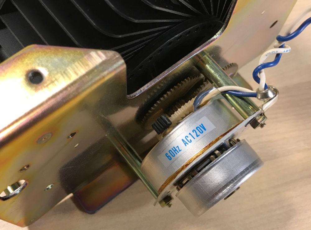

Surprisingly, the motor is just a simple, normal sized Copal II flip clock motor. I was a bit surprised by this, but I suppose I shouldn't have been. These are great little synchronous motors and have lasted 50 some years. Another surprise was finding this motor to be rated for 60 Hertz 120 volts, with no mechanism for changing from 50 to 60 Hertz operation as would be expected in Japan. This would be accomplished through a lever that would change the gear train.

As I mentioned, the clock setting knob connects to a rod with its position controlled by springs. When the knob is pulled down the rod engages the clock with what can best be described as a face gear system. What's interesting is that when the knob is turned clockwise, the clock advances. If you turn it the wrong way, counterclockwise, a kind of ratcheting slip clutch prevents any damage at all from occurring - it just makes this clicking sound.
Nice.

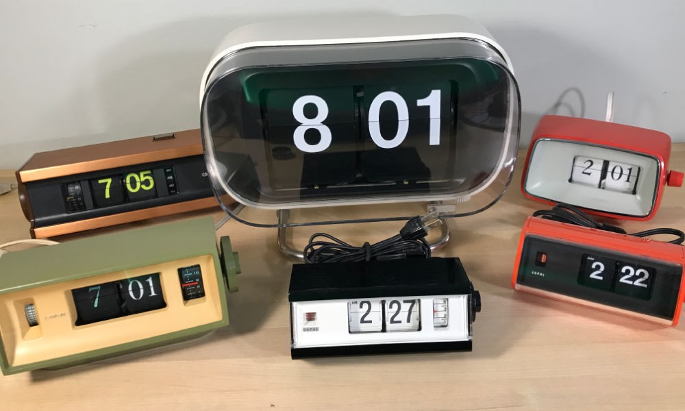

Click image for larger version  Name:	copals.jpg Views:	0 Size:	96.0 KB ID:	25137
The Copal 801 flip clock - Doc Brown's flip clock from the first Back to the Future movie of the mid-1980s. Clearly it stands above all the other Copals in my collection. It has appeal to any collector of Copals and to fans of the movie, "Back to the Future".
Sure, it's great to own a clock like the cool, time traveling kid, Marty. But how about owning a clock like the one owned by the man who invented time travel.
While this clock is the 24 hour version, and the movie version can be seen to be the AM/PM style, it remains a centerpiece of my Copal collection.
